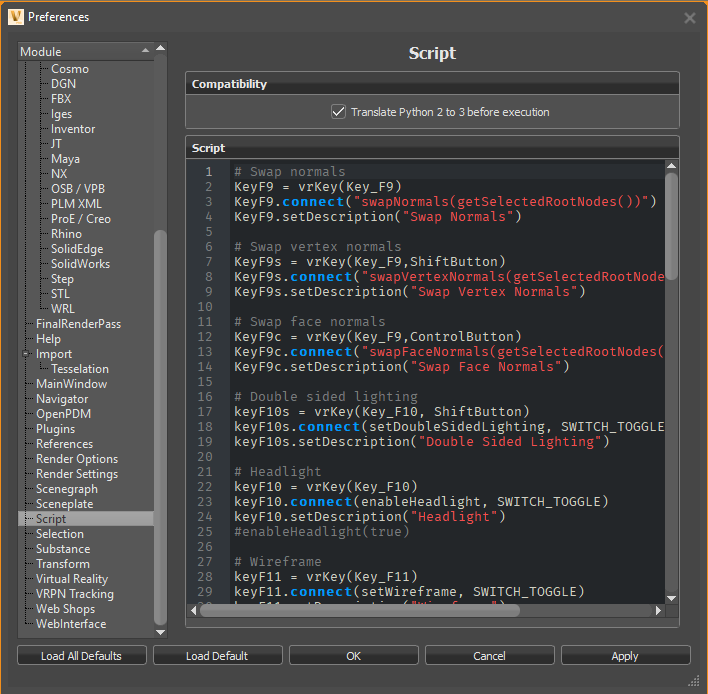

Find the key shortcuts in the preferences for scripts (Edit > Preferences > Scripts). These will always be included in the published VRED Go file.
Any changes to the scripts will not be exported.

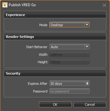

Use this dialog to set the type of viewing experience, render settings, and security measures for the VRED Go executable.
This section contains viewing mode options.
Sets the view used for the scene. Choose from VR and Desktop. VR files can be viewed in Desktop mode, if a supported VR device is not detected. See VRED Go Limitations for VR setup instructions.
This section contains options for setting the window behavior and size.
Determines the size of the viewer when opened. Select from Auto, Full Screen, and Fixed Size, which locks the aspect ratio during window resize. Use Alt+Enter to enter full screen for all modes.
Determines the width of the viewer, when Fixed Size is selected. Enter the pixel width of the viewer.
Determines the height of the viewer, when Fixed Size is selected. Enter the pixel height of the viewer.
This section contains options for entering a password and setting the file's expiry.
Sets when the VRED Go executable will expire and can no longer be viewed.
The maximum days is 60 days.
Sets a password the end user will need to access the VRED Go executable.
A password is not required.
With a scene loaded in VRED, select File > Publish VRED Go. This opens the VRED Go dialog, where you can choose the mode for the experience, render settings, and security features.
Click OK, select a location for the executable, give it a name, then click Save. Publishing (creating a VRED Go executable) can take some time. When finished, an executable is created in the designated location.
