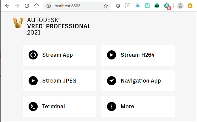

With a scene loaded into your version of VRED, in a browser, enter localhost: followed by the port number set in the preferences. For example, the default port is 8888; therefore, in the browser, you would enter localhost:8888 to access the web interface.
New Web Interface UI
The Web Interface provides a way to access the following:
