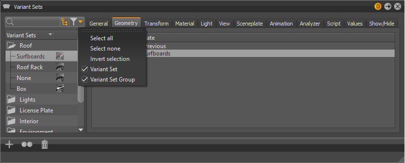

Use the Search field to find specific variant sets. Enter a string in the field and/or click
to use the Filter and its menu options and/or
Filtering is on when the filter changes from grey to orange. Click the arrow right of it to access its menu.
Enter a string in the Search field.
Click
and select an option from the menu. Choose from:

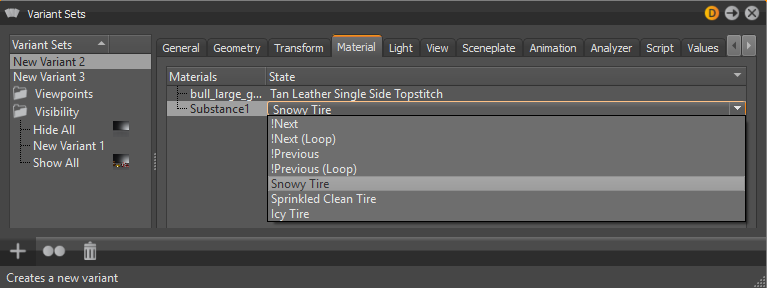

There is a collection of states, not user-defined. These are relatively self-explanatory. For example, the “!Next” state changes to the next state within that variant when the hotkey is pressed. Some states are not available in all contexts.

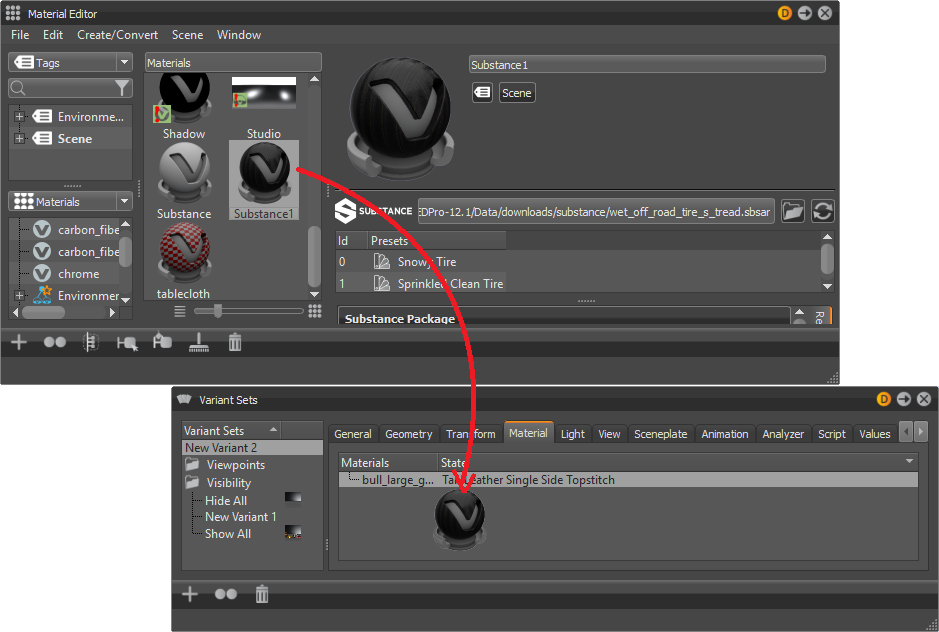

Creates or modifies the material variants. The supported types of materials variants are switch, Substance, and X-Rite materials. To create a material variant, drag a material node, such as a Substance, from the Material Editor to the right section in the Material tab.
