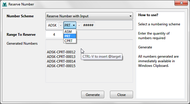

Share Numbering Schemes for Items and Files
Optimize data management of related items and files by sharing numbering schemes. Use Data Standard to reserve number ranges.

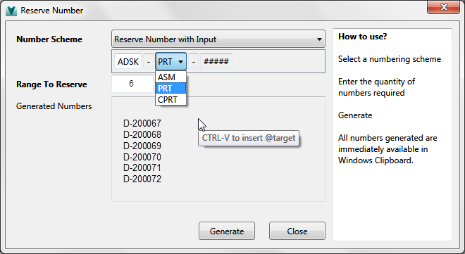

When creating a new iPart, perform these steps:

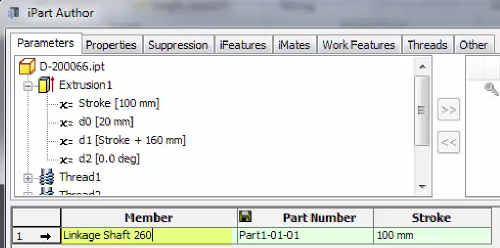

- Go to the Add Member table, copy the file name, and paste it into the Member field.

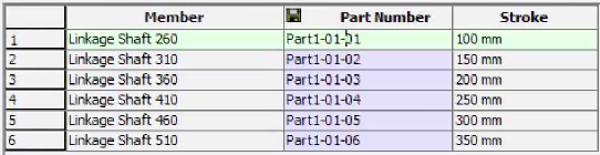

- Insert rows for additional members as needed.
- Modify the values for the added member rows.

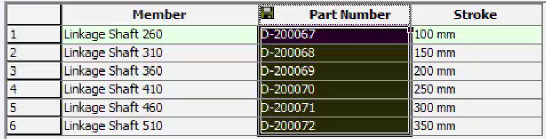

- Use Data Standard in Vault to reserve a range of numbers.
- Copy the reserved numbers and paste them into the Part Number column in the member table.
- Right-click on the new members in the Model Browser and select Generate Files.
- Check the new member files into Vault.
