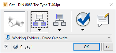

The Get dialog has two view settings: collapsed and expanded.
Collapsed View |
Expanded View |

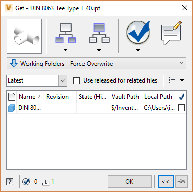

![]() The collapsed view provides an express workflow for checking files and folders out of a vault. |

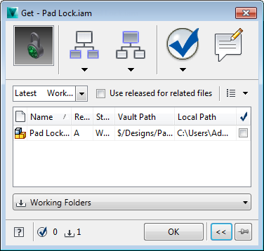

![]() The expanded view provides more information about the files available for checkout. Additional settings are also available in this view, such as working folder preferences or released bias enforcement. |

Select Revision
Note: The Revision feature is available in Autodesk Vault Workgroup and Vault Professional.
Displays all revisions available for the file. Select the revision that you want to check out from the drop-down menu. The latest version of the leading revision is automatically selected if you choose Latest from the drop-down menu, or if multiple files are selected for check out.
Note: See
Understand Revisions for more information.
Use released for related files check box
Gets the released versions of any related files selected for check out. |
View Settings
Controls how files in the vault are displayed. |
Grid Controls
Right-click on the Get view pane to customize how files are displayed, including which columns are included, how files are aligned, and how files are sorted. Refer to Custom Grid Options for more information. |

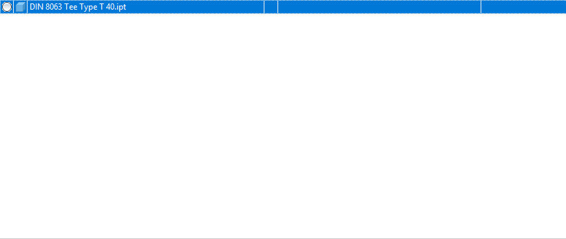

Selected for Check Out Column
Shows the files currently selected for checkout. Any selected files are downloaded to the local working folder as read-write files and can be modified. Unselected files are downloaded as read-only to the local working folder and cannot be modified. This is called a Get File event. |
Object Selection Counters
Shows the number of files selected for checkout
For example, in this image there are 4 files selected for checkout and 11 additional files listed for download. |
Pin Dialog in Expanded Mode
When the dialog is expanded, it does not retain that mode when next opened. Click the Pin button
Expand to Show Details
Click the expand button to toggle between collapsed and expanded view of the Get dialog. |
