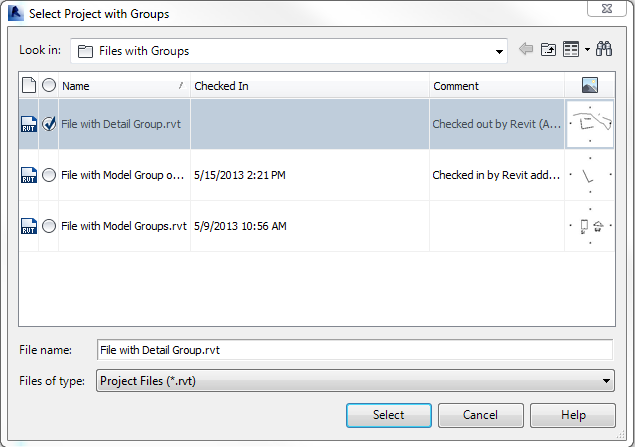

    The Select Project with Groups Dialog opens.
  3. Select a .rvt file and click Select to see which groups are available.

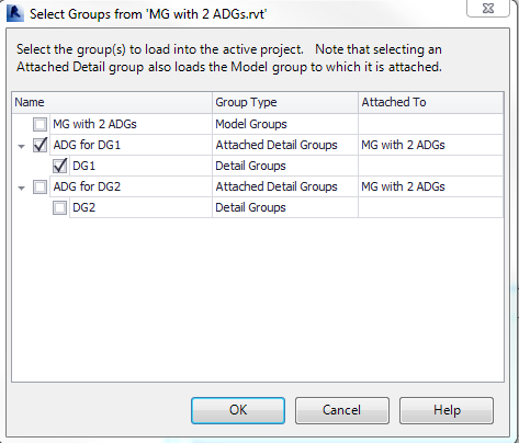

    Rules for Selecting Groups
      Unlike in Revit, you can select which groups are loaded from Vault.
    • If a parent group is selected, all children groups are automatically selected for loading.
    • If a child group is deselected, the parent group is automatically deselected and will not be loaded either.
    • If a file has an attached detail group type and that group is chosen, all children files are loaded as well as its model group.
    • Groups may have the same name within one file only if they are different group types.
  4. Select one or more groups to load and click OK to load an instance of the selected groups into the current Revit project.
