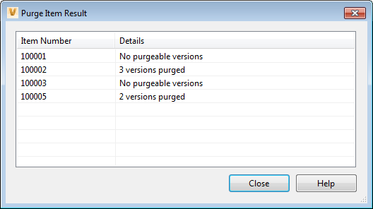

Review the details of a purge on the Purge Item Result dialog.
After you Purge Items with the Vault Client, the Purge Item Result dialog displays. This dialog shows the item numbers for all items that were selected for purge, and the number of versions of each item that were successfully purged.
If an item had no versions that met the purge criteria defined in the lifecycle control settings, or if the item is not assigned to a lifecycle, a status of no purgeable versions is displayed.
