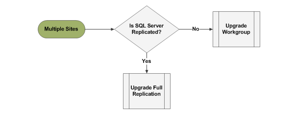

Autodesk Vault supports two styles of replicating data across multiple sites. First is a workgroup where there are multiple installations of the Vault server connecting to and sharing one SQL server. The second type is full replication where there are two or more replicated SQL servers. Further details are available on the Vault wiki.
The concept of an intermediate installation is introduced in the section.
Upgrade Three or More Releases under Single Site within this document. The purpose of the intermediate installation is to ensure proper migration of the SQL database (this migration applies to the database not the content). In a multi-site or replication environment, the first server upgraded migrates the SQL database. Therefore installation of intermediate Vault releases is only required for the first server upgraded. After the first site is migrated to the final release, all of the other sites can install the final release and skip intermediate releases of Vault server.
Upgrade Workgroup
In a workgroup any of the Vault servers may be the first to upgrade. The selected site will also migrate the SQL database. All other sites will be unable to access the SQL server until they are brought up to the same product, release, and service pack.
Best practice is to start with the site that has the fastest connection to the SQL server. When ready to perform the upgrade, follow the steps outlined in the section Single Site. Upgrade the selected server to the final release and service pack before moving onto other sites.
When the first site update is complete, install Vault server at the remaining sites. If upgrading from Vault server 2009 or older, uninstall the Vault server at all other sites. Then install the final release and service pack, skipping intermediate releases. The intermediate server releases are not required at the other workgroup sites.
Upgrade Connected Workgroups
Migration of a fully replicated environment must start with the Publisher workgroup. All subscriber workgroups must be online and available during migration of the publisher. As long as one Vault server and the SQL server are available from a workgroup, that workgroup is considered available. If a subscriber workgroup is offline and cannot be made available, postpone the migration.
Validate the replication status of all workgroups and databases prior to migration. If replication issues exist, they must be resolved before proceeding. Details about replication status are available on the Vault wiki under Administrator’s Tasks/Manage Replication.
Migrate one site from the publisher workgroup following the steps in the section Single Site. Installing the Vault server automatically migrates the SQL database. The SQL database migration is automatically replicated to all subscriber databases. After installation of the Vault server at the first site is complete, install the final Vault release, service packs, and hot fixes at all other sites across all workgroups.
If intermediate server releases are required they are only necessary on the first server. All other Vault servers in all workgroups should install the final Vault server release, service packs, and hot fixes, skipping intermediate releases.
