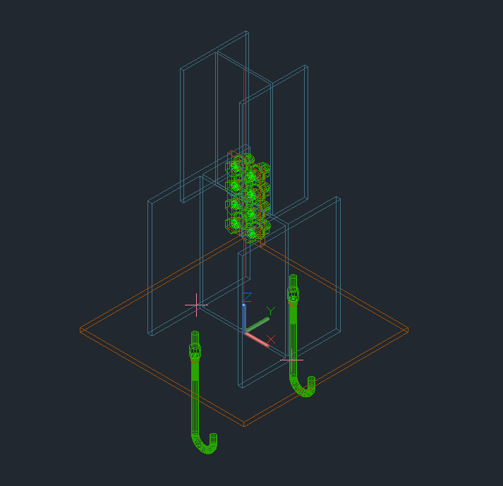

Creating the connectors
Now we can use all the methods created above to create some elements and connect them with various connection types. Update the first Create() method to include the code as shown below:
Code Region: Connect objects with welds
public void Create()
    using (DocumentAccess da = new DocumentAccess(null, false))
		     StraightBeam bottomColumn, topColumn;
		     CreateStackedColumns(out bottomColumn, out topColumn);
		     if (null != bottomColumn && null != topColumn)
			       ConnectColumnsWithBolts(bottomColumn, topColumn);
			       Plate basePlate;
			       CreateBaseplateWithAnchors(bottomColumn, out basePlate);
			       WeldColumnToPlate(bottomColumn, basePlate);
		     da.Commit();
Prior to running this command in Advance Steel, you will need to add the necessary Informational Attribute directives in the AssemblyInfo.cs file as shown in the Hello World Walkthrough.
After running the CreateConnectors command in Advance Steel and zooming in, you should see something like this:
