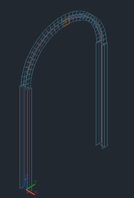

Prior to running this command in Advance Steel, you will need to add the necessary Informational Attribute directives in the AssemblyInfo.cs file as shown in the Hello World Walkthrough.
After running the CreateElements command in Advance Steel and zooming in, you should see something like this:
