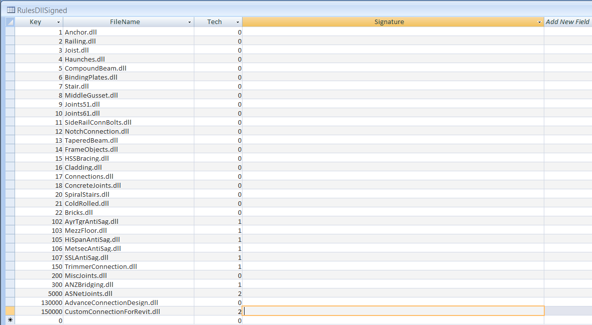

  2. Open RulesDllSigned table.
  3. Add a new record:
    1. Key - Use a value well above the standard Advance Steel range, e.g. 150000.
    2. FileName - The name of the dll (library) that implements your connection.
    3. Tech - This should be 2 for .NET Connections. All options include:
      1. "0" for connections using COM API, implemented in C++.
      2. "1" for connections using COM API, implemented in .NET.
      3. "2" for .NET API connections.
    4. Signature - not currently used.

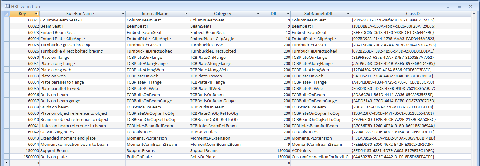

  4. Open HRLDefinition table. Add a new record:
    2. Rule run name - How your connection will be seen in Advance Steel.
    3. Internal name - Use a unique simple name with no spaces. This will be used to invoke your connection.
    4. Category - Used to group connection families.
    5. Dll - The key you used when added the new record to the RulesDllSigned table above.
    6. SubNameInDll - The complete name of the class that implements the IRule interface, including the namespace.
    7. ClassId - Generate a new unique GUID here for your connection. It will only be applicable if you create a connection design module for your connection as well.
