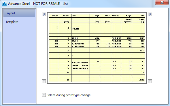

On this tab of the properties dialog box, you can define the fixed points of the list. Each checkbox corresponds to a corner of the frame of the list. Selecting two check boxes on a side prevents the list from extending on that side.
| The Delete during prototype change check box | Controls the list behavior during the prototype change. If checked, the list is deleted. |

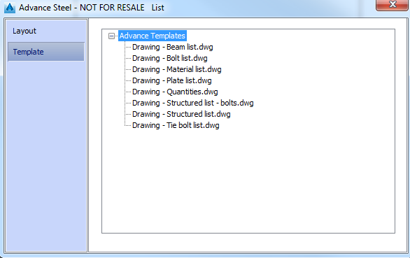

This tab lists all available templates. By default, the templates are installed in ...\ProgramData\Autodesk\Advance Steel 2022\[INSTALLATION LANGUAGE EXTENSION]\Shared\Support\BOMTemplates\.
