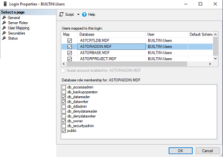

You can customize Advance Steel databases using the Management Tools, granted you have db_datawriter and db_owner rights on said databases.

Advance Steel requires db_owner rights for most of its databases to be customized, db_datawriter rights are not sufficient. The following functionalities require in addition to read access both db_datawriter and db_owner rights, each on the mentioned databases:

The database rights need to be specified per database and per user. They can be specified for an entire user group, it is not necessary to apply the settings for every individual user.
Note: Forgetting to give a user db_owner rights to one Advance Steel database will often cause the Advance Steel functionalities that require write access to that database to behave as if that particular user has read-only access even if the user has write access to that database.
