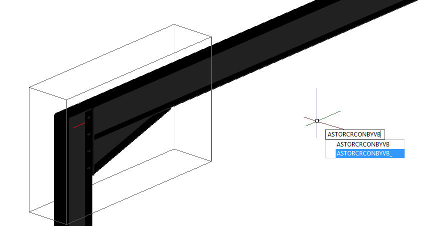

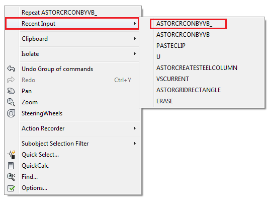

You can also type the command you want to repeat in the command line or access the last commands from the Recent Input menu.
To repeat the command with the last used parameters, choose the command name that has an underscore at the end, from the Recent Input menu, or add a "_" (underscore) after the main command name if you're typing it in the command line.
