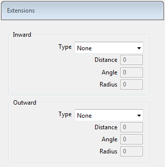

Extensions (PartMaker, Advanced Milling Toolpaths)
Use the Extensions page to add another lead to the existing ones.
Inward — Use these settings to add an additional Lead in before the existing one.
Extension of Straight with a Distance of 10, and an Angle of 0. Leads of Surface normal arc.
Outward — Use these settings to add an additional Lead out before the existing one.
