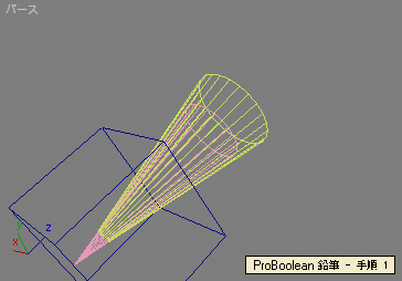

    --Creating a Pencil using multiple boolean subtractions
    --of a box, two cones and a cylinder:
    --Step 1: create a box and two cones, assign materials:
    theBox = box height:50 width:50 length:50 pos:[0,0,-2]
    theCone1 = cone radius1:3 radius2:20 height:80 heightsegs:1 pos:[0,0,15]
    theCone2 = cone radius1:0 radius2:15 height:80 heightsegs:1
    theCone1.material = standard diffuse:(color 255 220 200)
    theCone2.material = standard diffuse:black

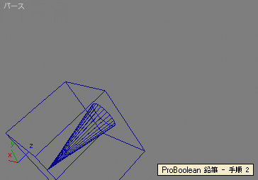

    --Step 2: Subtract both cones from the box
    ProBoolean.createBooleanObjects theBox #(theCone2,theCone1) 2 0 0

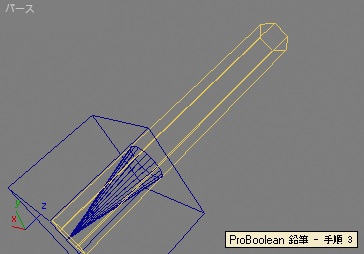

    --Step 3: Create a 6-sided cylinder and assign a material
    theCyl = cylinder radius:10 sides:6 height:150 smooth:false pos:[0,0,1]
    theCyl.material = standard diffuse:(color 255 200 100)

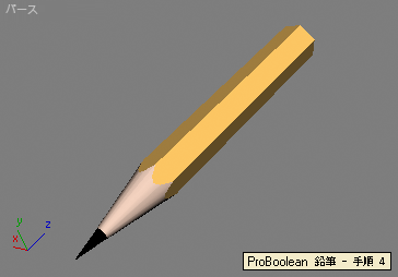

    --Step 4: "sharpen" the cylinder using the box with the conical hole
    ProBoolean.createBooleanObject theCyl theBox 2 0 0
