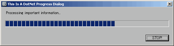

例:
    theObj = dotNetObject "MaxCustomControls.ProgressDialog"
    theObj.Show()
    theObj.text = "This Is A DotNet Progress Dialog"
    theObj.Controls.Item[0].text = "STOP!"
    theObj.Controls.Item[1].text = "Processing important information..."
    theObj.Controls.Item[2].value = 65
