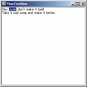

例:
    theFrm = dotNetObject "MaxCustomControls.MaxForm"
    theBox = dotNetObject "MaxCustomControls.MaxTextBox"
    theBox.width = 290
    theBox.height = 270
    theBox.Multiline = true
    theBox.Text = "Hey Jude, don't make it bad!\r\nTake a sad song and make it better..."
    theBox.SelectionStart = 4
    theBox.SelectionLength = 4
    theFrm.controls.add theBox
    theFrm.topmost = true
    theFrm.text = "MaxTextBox"
    thePtr = DotNetObject "System.IntPtr" (windows.getMAXHWND())
    theHwnd = (dotNetObject "System.Windows.Forms.NativeWindow").FromHandle thePtr
    theFrm.Show(theHwnd)
