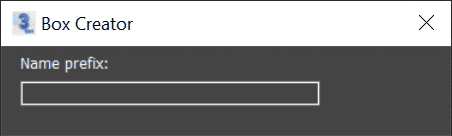

例:
    rollout boxCreator "Box Creator"
        --define an edittextwith width 100 and the label on top:
        edittext prefix_txt "Name prefix:" fieldWidth:200 labelOnTop:true
        --If the user entered a new name...
        on prefix_txt entered txt do
        --And the name is not the empty string,
        if txt != "" do
            --Create a new box at a random position
            --somewhere between the given coordinates:
            new_obj = box pos:(random [-100,-100,-100] [100,100,100])
            --Set the name of the new object to the prefix entered,
            --but add unique suffix to avoid duplicate names:
            new_obj.name = (uniquename txt)
            --And finally clear the edittext for a new entry
            --by assigning an empty string to the text property:
            prefix_txt.text = ""
    createDialog boxCreator 300 60 --create a Dialog from the rollout
