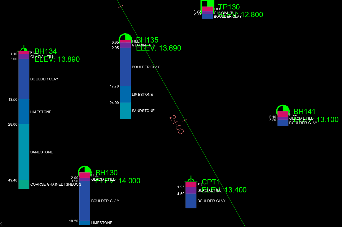

Generating 2D Sticklogs
To easily examine the borehole data from plan view the Geotechnical Modeler enables the you to create two-dimensional sticklogs associated with each borehole. The hatch patterns and styles utilized by this tool are managed by the included GeologyHatchPattern.config file. To generate and configure the 2D sticklogs:

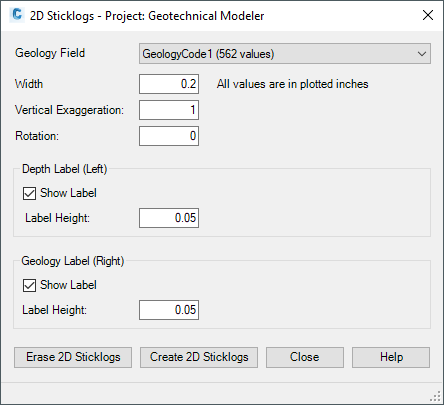

  1. Open the 2D Sticklogs window by selecting from the ribbon:
  1. Select the Geology Field used to generate the 2D sticklogs, hatches and associated labels.
  2. Specify the sticklog Width, Vertical Exaggeration and Rotation.
  3. If desired configure and toggle on the Depth and Geology Labels.
  4. Select Create 2D Sticklogs to generate or regenerate the sticklogs in plan view.
  5. Select Erase 2D Sticklogs to erase the sticklogs from the drawing.
