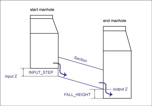

A section is a wastewater channel or pipe between network points. Sections are the only standard line feature of a wastewater utility model.
The data model stores both real pipe geometry and the network topology, which is a more abstract view. Physically, a pipe runs between two manhole structures and a manhole has a certain diameter. Topologically, a section runs from manhole (center) to manhole (center).
Use intermediate points to add detail so the line from manhole to manhole is more accurate.
In the wastewater industry model options, you can enable manhole/section validation. See Set Wastewater Industry Model Options.
The manhole/section validation checks the consistency of the bottom height in the section and manhole feature class. In the feature class form, attributes that do not match are highlighted, and a tooltip explains the inconsistency.
Wastewater data model: Section between two manholes. Physically the section is represented by a pipe that runs between the manhole structures.

END_Z |
Number |
The height above sea-level of the end point of the section, measured in meters. |

FALL_HEIGHT |
Number |
The water fall height at the end of the section, measured in meters. |

INPUT_DEPTH |
Number |
The depth of the section at the start of the section, measured in meters. |
INPUT_STEP |
Number |
The difference between the soil elevation and the input elevation in the start manhole, measured in meters. |
INPUT_Z |
Number |
The height above sea level at the input point of the section, measured in meters. |

| OUTPUT_DEPTH |
Number |
The depth of the section at the end of the section, measured in meters. |
| OUTPUT_Z |
Number |
The height above sea level at the output point of the section, measured in meters. |
