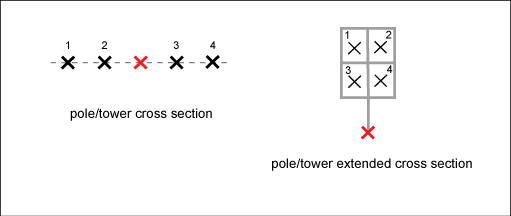

A pole or tower cross section is a view of a pole or tower looking down from the sky.
Tower with two conductors. The standard cross section displays two snap points for two more conductors. Use the standard cross section for data acquisition, and the extended cross section is for visualization only.

  1. Design the cross section layout. For example, use AutoCAD tools to draw a pattern, so you can later digitize the template features quickly.

  5. Digitize the following components using the feature classes under the Cross Section feature class:
    • Origin: Right-click the CS Origin feature class. Click Digitize With Form.
    • Snap points: Right-click the Snappoint feature class. Click Digitize With Form.
  6. For the snap point features, use the feature class forms to enter the following:
    • Position Number: On the General tab, enter a number for each snap point. Otherwise conductors cannot be assigned to cross sections automatically.
    • CS Origin: On the Details tab, set the FID_CS_ORIGIN attribute to the FID of the CS_ORIGIN.
