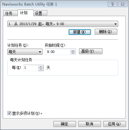

    In the Windows Task Scheduler, the Schedule tab, click the New button, and specify when and how often the task is to run. You can add as many schedules as necessary.
  6. 单击“确定”。
