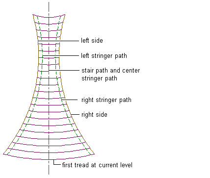

The stairs outline component of a custom stair is delineated by the left and right stair sides, the nosing of the first tread, and the front of the last tread or landing.

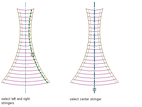

Stair stringers can be selected as linework, or they can be automatically generated by AutoCAD Architecture 2023 toolset. After you create a custom stair, you can replace stringer paths. You can add or modify stringers by editing the stair style. The stair style applied to the custom stair must have stringers defined in that particular stair style. If the stair style does include stringers, the left and right stringer path lines are converted to appropriate stringer geometry. The current stair properties govern the appearance of stair components in various representations.

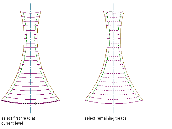

Create the linework for your custom stair using lines, light-weight polylines, or arc segments. All tread lines must intersect with the sides of the stair. Graphics representing the stringer paths must be continuous throught the path of the stair.

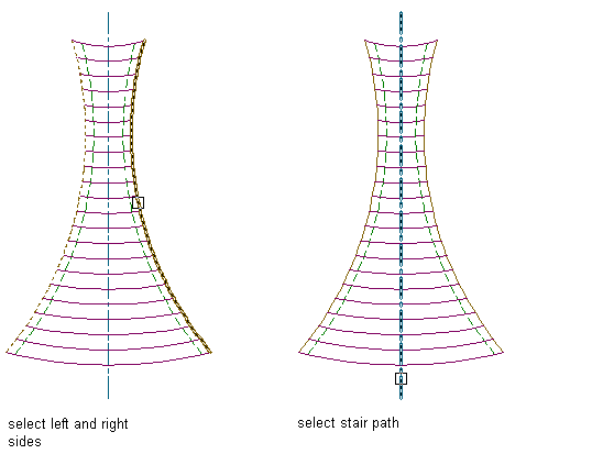

Linework. Only lines, light-weight polylines, or arc segments that intersect all treads can be selected for the stair sides.
Only single or multi-segment light-weight polylines or arc segments that intersect all treads can be selected for the stair path.
Only lines, light-weight polylines, or arc segments that intersect the stair sides can be selected for the stair treads.
