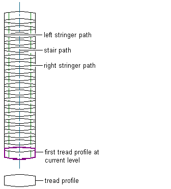

Use this procedure to create a custom stair from tread profiles. Use defined profiles generated from closed polylines for custom stair treads. All tread profiles in each stair run must either intersect or overlap.
The stairs outline component of a custom stair is delineated by the left and right stair sides, the nosing of the first tread, and the front of the last tread or landing.

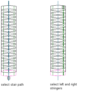

Linework. Only single or multi-segment light-weight polylines or arc segments that intersect all treads can be selected for the stair path.

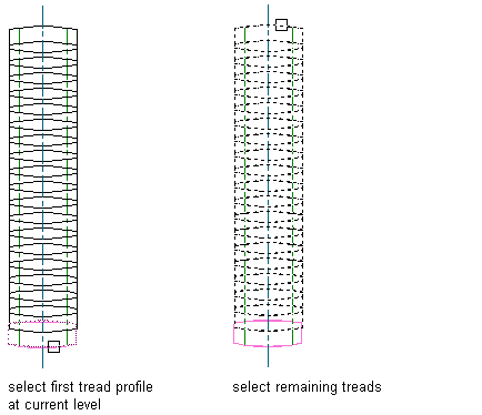

Only defined profiles can be selected for stair treads.

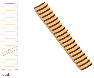

The custom stair from tread profiles is generated.
Once you create a custom stair, you can convert any part of it to a landing.
