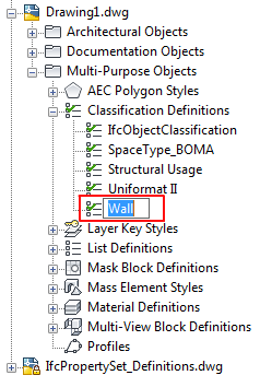

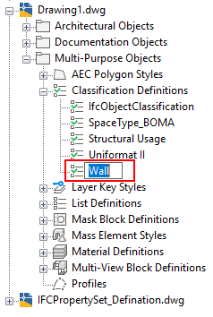

- In the Style Manager, expand the drawing you just created
Multi-Purpose Objects, right-click Classification Definitions and select New.
- Enter Wall for the new classification name.

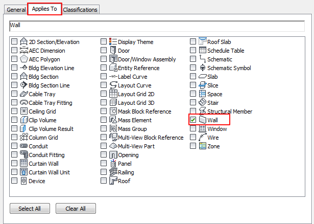

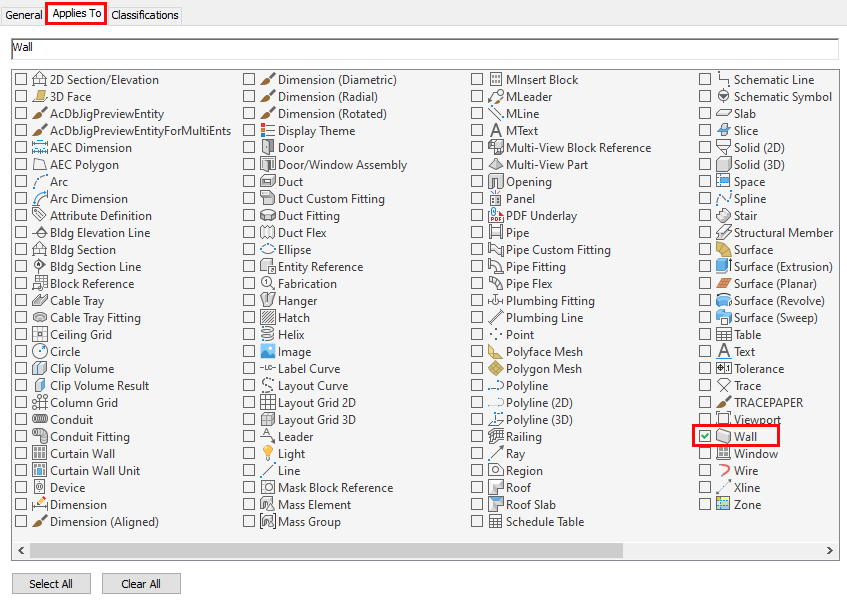

- Click Applies To tab and select Wall.

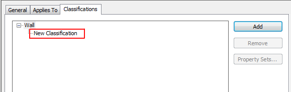

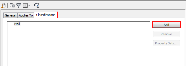

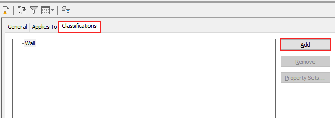

- Click Classifications tab and click Add.
- Select New Classification and specify the following:

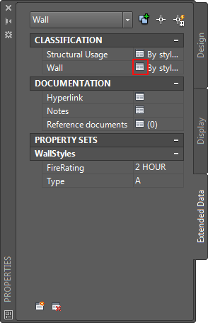

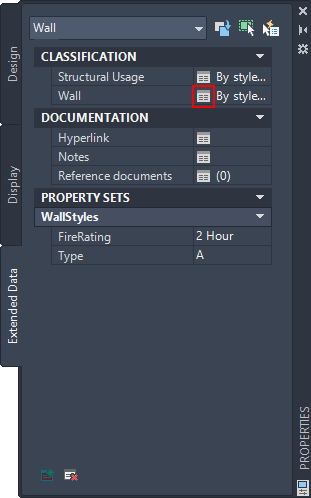

- In the drawing, select the wall.
- In the Properties palette, on the Extended Data tab, under Classification, click the button next to Wall.

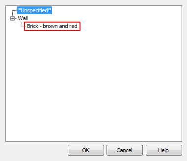

- In the Select Classification dialog box, select Brick - brown and red.
- Click OK.
