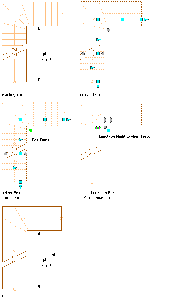

Note the initial flight length of the existing stairs.
- Select the Lengthen Flight to Align Tread grip.
The flight is lengthened as the tread edge is now aligned with the turn center.
Lengthening a Flight to Align a Tread Edge with Turn Center
