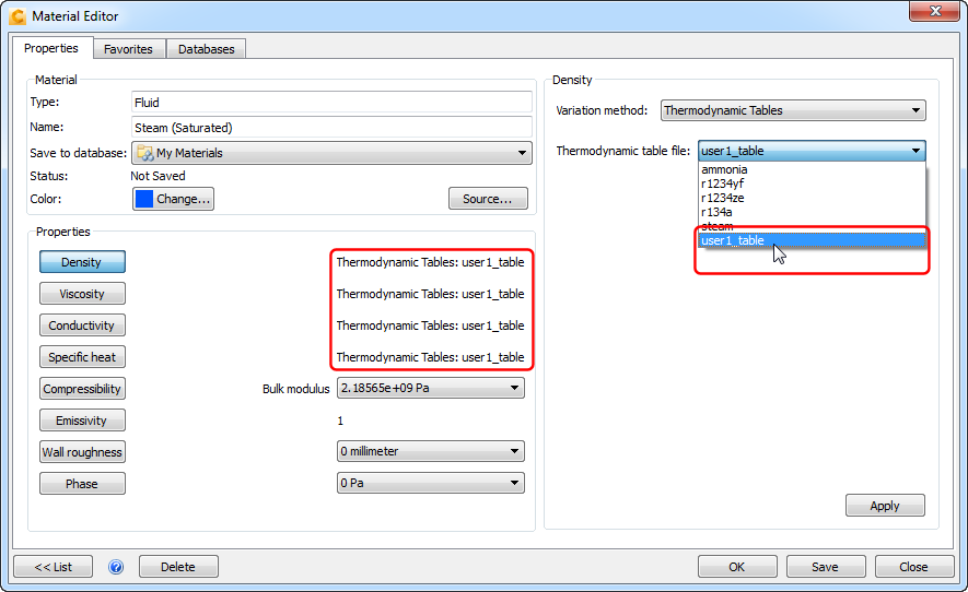

The .dat files contain property information for saturated, superheated, and sub-cooled fluids. They are located in the top-level folder of your Autodesk® CFD installation and you can view the contents with any text editor. For example, in Windows 7, ProgramData\Autodesk\CFD *
Using the default .dat files as guides, you can create your own custom thermodynamic table data files. Copy and edit one of the files included in your installation, or create a file from scratch. Once you have your custom file, you can select it for use with your fluid material.
