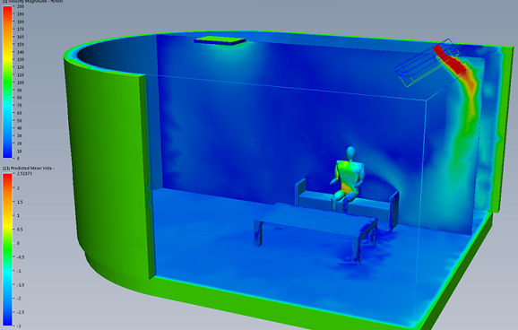

Use PMV to assess the impact of the room design on the occupants. The best way to display PMV is on the surfaces of the model. To plot PMV, right click off the model, select Global result, and select it from the menu.
In the image, velocity is plotted on the results plane, and PMV is plotted on the surfaces:
The PMV values indicate that the human occupant is might not be too comfortable--the left arm and leg are really cold!

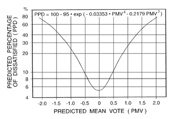

PPD is an index that establishes a quantitative prediction of the percentage of people that are dissatisfied with the thermal conditions, as determined from PMV. The PPD is highest at the ends of the PMV range:

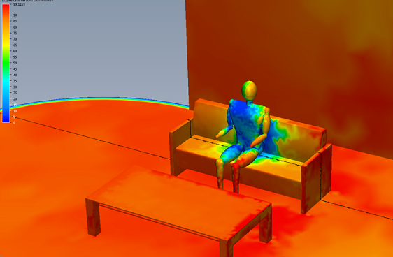

This image shows the PPD of the same scenario:
The PPD is highest on the left arm and leg, confirming what the PMV indicated about this occupant.
