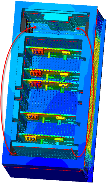

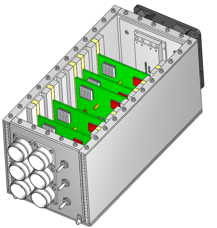

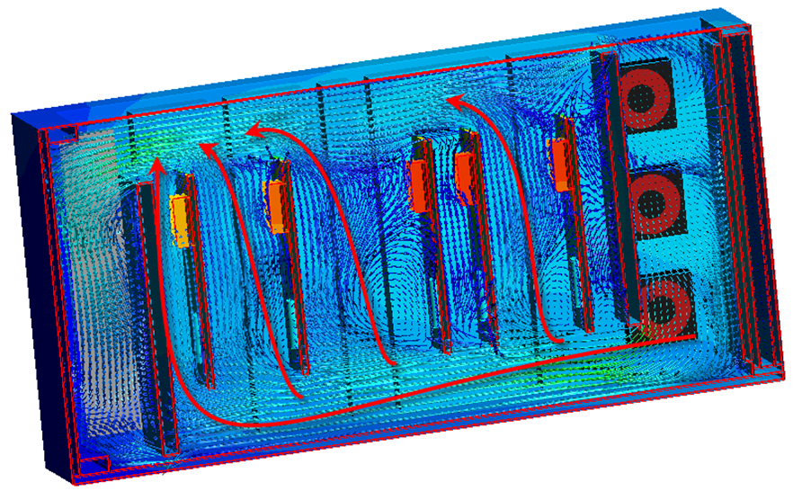

A fan circulates air contained within the enclosure. Because it cannot enter or leave, it is essential that circulating air efficiently removes heat from critical components, and transfers heat to the casing. Conduction paths between critical devices and the casing are also very important for effective cooling.

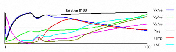

Autodesk® CFD stops the solution either when the specified number of iterations have elapsed or when the solution is converged, whichever comes first. To ensure the analysis is not stopped before converging, set the Iterations to Run to 500. Most analyses converge within 200-300 iterations so 500 should provide an adequate margin.

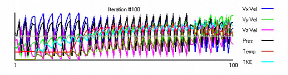

Oscillating convergence, as shown by a "saw tooth" convergence plot, is a problem that occasionally occurs when internal fans are defined with a fan curve:
This is caused when the operating point of the system varies significantly from one iteration to the next, and the operating point on the fan curve varies with it. The intersection of the fan curve and the system curve is the operating curve of the fan. If the solution changes too rapidly from one iteration to the next, this point develops a repeating overshoot/undershoot, and the "saw tooth" convergence plot is the result.
To fix this issue:
This change slows the solution of the velocity and pressure variables, and prevents the operating point from varying do dramatically:
