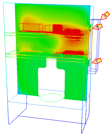

The following shows that no results are displayed on the heat exchanger device (A). To view its effect on the system, display temperature near the inlet and outlet:
The air at the heat exchanger inlet (B) is clearly warmer than the outlet air (C). The temperature drop indicates that this heat exchanger has removed heat from the working fluid.
