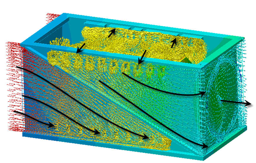

Air enters the enclosure from the environment, passes through the device, and is exhausted to the environment. In most applications a fan moves the air, and the incoming air temperature is known. Buoyancy effects are negligible. Heat dissipated by the components is convected away by moving air and conducted through the enclosure. Radiation is typically negligible for these applications.

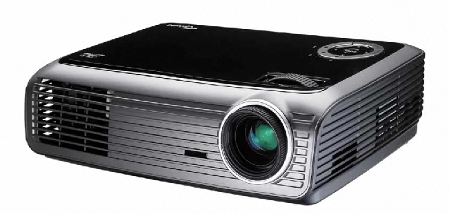

Projector

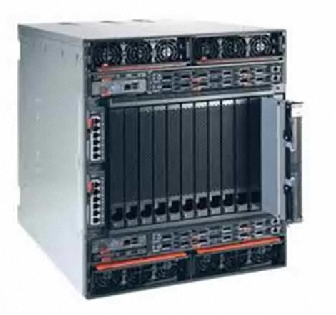

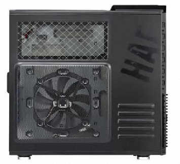

Computing hardware

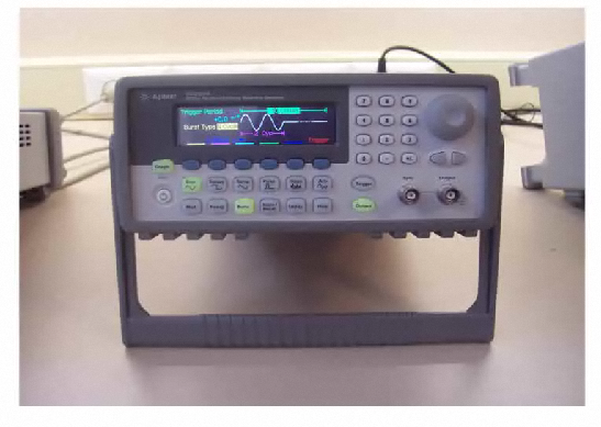

Lab equipment

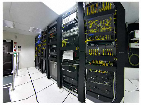

Data center equipment

A basic guideline for a high-quality analysis model is that the mesh distribution be sufficient to resolve the flow and temperature gradients efficiently. In regions where the flow circulates or experiences large gradients (such as in wakes, vortices, and separation regions), a finer mesh is required.
For most models, use Automatic Sizing to define the mesh distribution. It may be necessary to locally refine the mesh on geometric features that are highly detailed. For more information about Mesh Autosizing and model preparation...
In some cases, it may be necessary to adjust the Minimum Refinement Length to reduce their effect on the overall mesh count.
