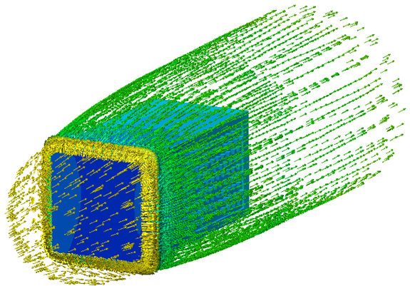

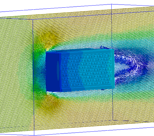

In some applications, a device with forced cooling is subjected to appreciable external cooling effects. A fan inside the device provides component cooling, but a high-speed (incompressible) flow around the device convects heat from the exterior of the enclosure. In the other forced-cooling applications, this effect is either neglected or simulated with a film coefficient boundary condition. In this application, the heat transfer from the exterior of the enclosure is modeled with an air volume that surrounds the device.
Applications
Modeling Strategy

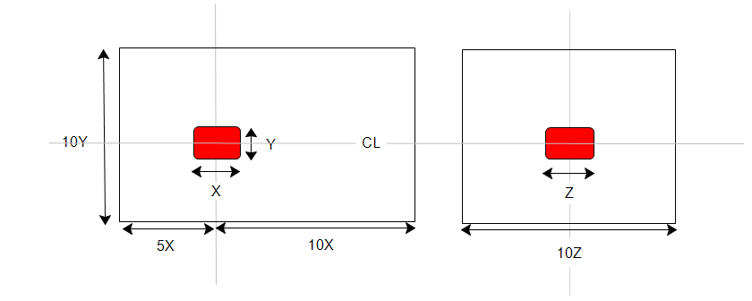

A volume surrounding the device must be constructed. In some cases the surrounding volume is a physical structure, such as a wind tunnel. In other cases, the device is in either a very large room or an open environment:
The device can either be sealed or vented. If sealed, air within the device is separated from the surrounding volume. If vented, air in the surrounding volume passes around as well as through the device.

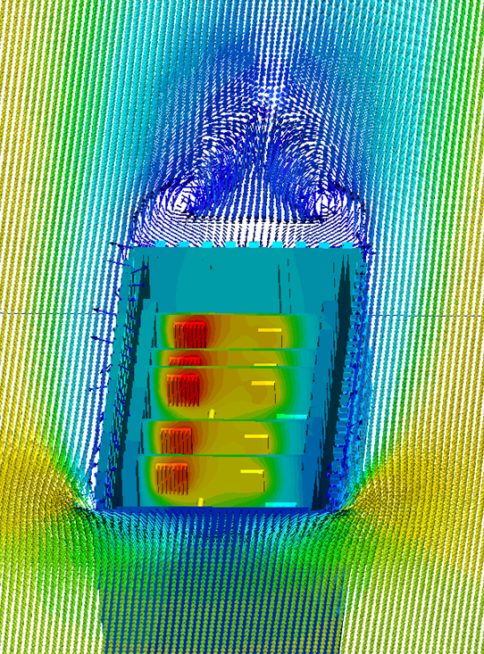

Flow Distribution
Component Temperatures
For more general information, use the extensive collection of results visualization tools to extract flow and thermal results.
