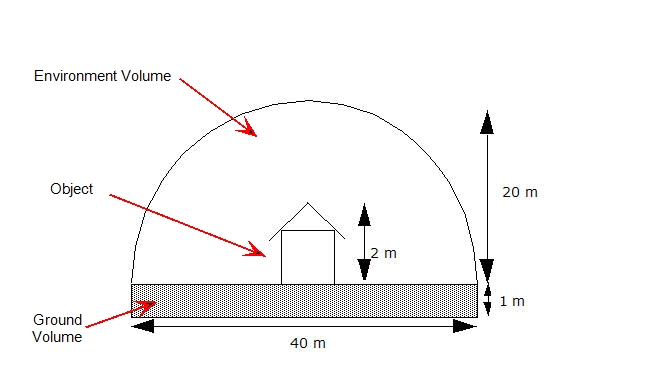

To properly compute the solar heating of an object, it must be fully enclosed by a larger volume that represents the environment. A volume representing the ground can also be included in the model, but is not required. The purpose of both regions (environment and ground) is to properly simulate the effects of reflected and emitted radiative heat transfer between the object and its surroundings. These two elements in a solar model allow for proper simulation of the indirect solar flux to and from the ground and the radiative energy loss and/or gain to the sky.
The ground volume should be approximately a meter thick. The thickness is significant only if diurnal heating over several days is studied, in which case it is necessary to compute the thermal inertia of the ground. The ground part should be approximately 20 times wider than the studied object.
The shape of the environment volume is not critical, and a hemisphere or cube are the most convenient choices. The environment volume should extend at least 10 times the height of the objects in the analysis model. A smaller environment can be used, but if natural convection is analyzed, a small volume will influence and potentially complicate the buoyancy-induced flow. Also, if diurnal heating is analyzed, a cold sky temperature that is too close to the object will artificially cool the object through conduction.

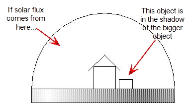

The relative locations of objects in an analysis model are important because shadowing is computed by the Solar Heating model. When an object blocks solar flux (either partially or completely) from hitting another object, that blocked object is shadowed. Such an object is still subject to receiving indirect radiant heat flux from the sky, the ground, and surrounding objects.

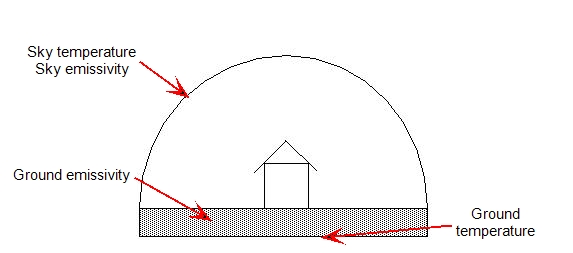

Temperature boundary conditions and emissivity values should be specified for both the ground and sky.
The ground temperature depends on the location on the Earth, and should be specified on the external surface of the ground volume. The emissivity of the ground should be specified as a property of the ground material. This value depends on the type of material. Grass surfaces, for example, may have an emissivity of about 0.3, while asphalt may have an emissivity of about 0.8. White surfaces such as an airport tarmac, are highly reflective, and would tend to have very low emissivity values.
Apply the sky radiation temperature to the exterior surface of the dome. This temperature typically falls within a narrow range, roughly between 0 and 30 °C. Note that this is not the air temperature. During the day, the sky temperature is nearly the ambient temperature. At night, however, the sky temperature falls to about 0 C. On very cloudy nights in warm climates, the sky temperature may be warmer than this. On clear nights in cold climates, the sky temperature can be as cold as -15 C.
The amount of cloud cover and the amount of ambient light affect the amount of radiant energy that is reflected off the sky and back to earth (the albedo). Use the value of emissivity specified on air to control the emissivity of the sky (and hence the reflectivity). The emissivity controls the amount of reflected energy: (reflection = 1-emissivity).
To study diurnal heating, specify the sky temperature as a transient boundary condition, and assign the emissivity of the air (which is automatically assigned to the exterior surface of the environment volume) as a function of temperature. During the day, high sky temperature corresponds to lower emissivity. During the night, low sky temperature corresponds to higher emissivity values.
