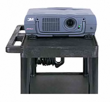

Projector on a table

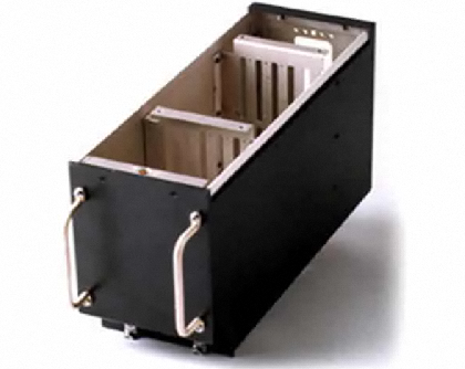

ATR box assembled at the base

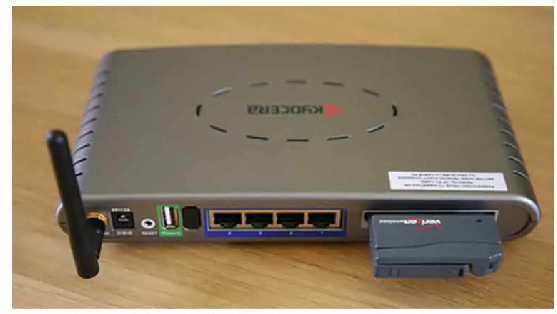

Router, hard-drive, inverter resting on a table or platform

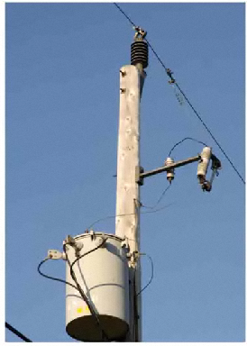

Telecommunications module or transformer suspended from a utility line or pole

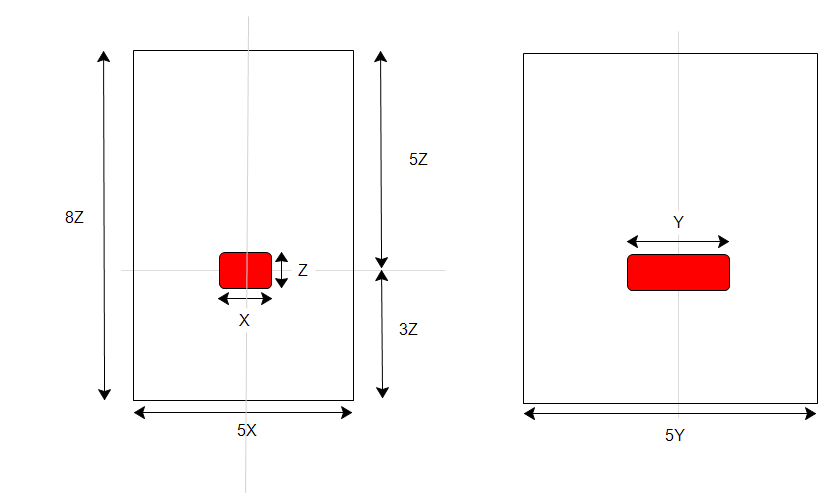

Air-Mounted
Model a device mounted far from physical boundaries, such as on a pole or from a wire. An example is a telecommunications module suspended from a utility line. (This is sometimes called the "chimney" configuration.)
The top and bottom surfaces are open. Air enters from the bottom and exits through the top.
Construct an enclosure around the device, and center it horizontally within the enclosure. The size of the enclosure should be based on the size of the device, as shown below.
Position the light vertically one third of the total length from the bottom opening.
The side view is shown on the left; the front view is shown on the right:

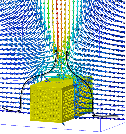

Air-mounted and Wall-mounted

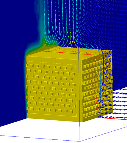

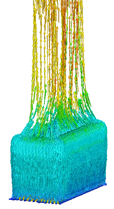

Ideally, the flow should enter through the bottom surface of the region, curve around the device, and accelerate in a plume, as shown on the left. Flow should not enter from the top opening, as shown on the right:
If the flow does enter from the top, there are two recommended corrective actions:
Apply a Film Coefficient boundary condition to the top surface. Specify the Film coefficient = 2 W/mK 2and Reference Temperature = ambient temperature + 1 degree.
Refine the mesh above the fixture. A convenient method is to create amesh refinement region directly above the fixture. The flow gradients will be computed more accurately by focusing the mesh in this region.

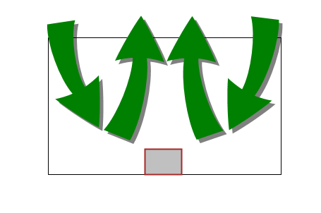

Ideally the flow should enter from the sides of the opening, and exit through the center(forming the plume from the device), as shown on the left. Flow should not enter from just one side and exit near the other side, as shown on the right:
If the flow enters from one side and exits through the other, the recommended action is to refine the mesh above the fixture. A convenient method is to create a mesh refinement region directly above the device. The flow gradients are computed more accurately by focusing the mesh in this region.
