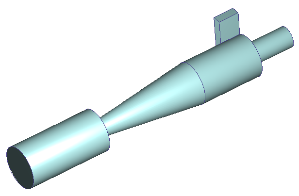

Cyclone separators typically display flow patterns consisting of highly rotational flow and strong streamline curvature. They are very sensitive to the turbulence model and mesh distribution. These guidelines list the basic techniques needed to successfully simulate cyclonic flows.
Use a fine, uniform mesh distribution.

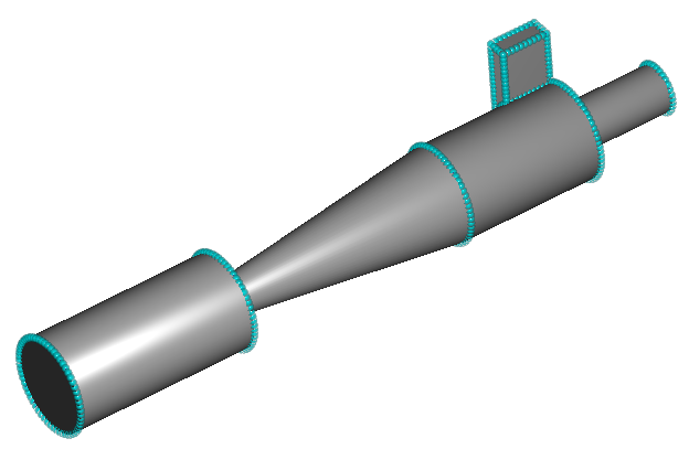

On the Mesh Context Toolbar, change the Type to Manual, and assign a constant size. Here is an example of a recommended mesh distribution:
On the Mesh Enhancement dialog make the following settings:
The reason such a fine mesh is used near the walls is that we've found that a Y+ value less than 4 is needed for best results.
