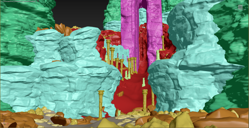

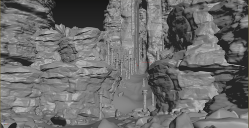

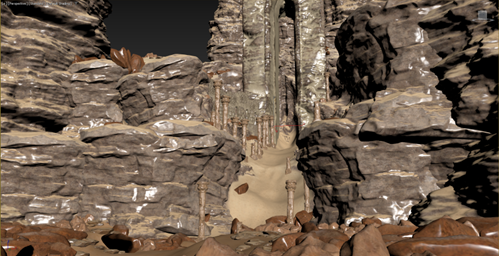

- Use the Show drop-down to select your display preference for the stage. To increase the performance of a stage, the default viewport setting is to show the stage using the stage node’s wire color or 3ds Max Wire Color. You can also display a stage with the USD Display Color (deriving colors from USD Prim data) or USD Preview Surface (which uses the imported material from USD).
Wire Color and Proxy
USD Display Color and Proxy
Wire Color and Render
USD Display Color and Render
USD Preview Surface and Render

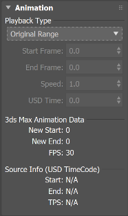

Animation
Use Playback Type settings to configure the animation of your USD stage. You can specify an original range, a custom range, a custom start and speed, or specific USD TimeCode.
Note: 3ds Max is set to 30 frames per second (FPS) by default so animations are often converted to a new start and end time (if the source USD animation doesn't match the scene's FPS). USD Souce animation info in this dialog is expressed in USD TimeCodes per second (TPS). 3ds Max Animation Data displays the result of converting the animation to 3ds Max data, matching the frames per second set in your 3ds Max scene, and applying playback settings.

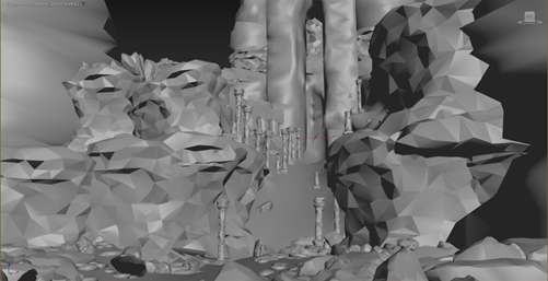

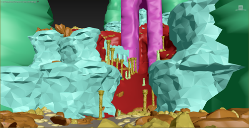

Mesh Merge: This option consolidates the meshes for better viewport performance, but there is no single optimal setting that works across all scenes. Select Static(default), if your USD set contains only static assets. For scenes with transform animations, you may get better performance by choosing Dynamic, especially if the scene is composed of many small objects with animated transforms or vertex animations.
- Use the Visualize toggle to enact your results in the viewport.
- Use the Merge Thresholds options to configure consolidation options for your viewport performance.
Tip: Experiment with Mesh Merge options and thresholds to achieve the best performance with your scene.
Important: The Visualize option will indicate meshes that have been merged by displaying them with the same color. This only affects the viewport and does not have any effect on the renderer.
