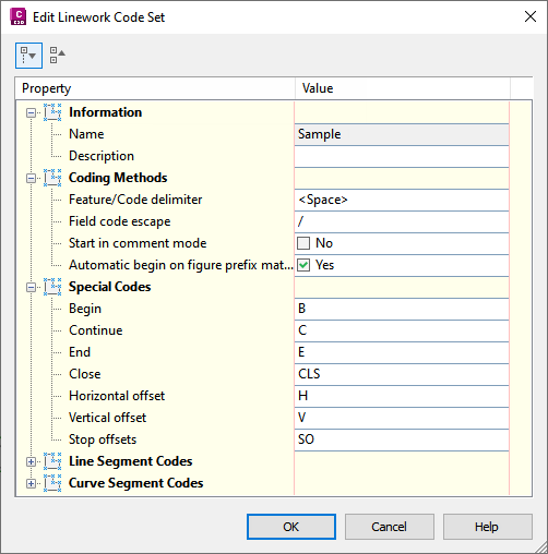

  3. Use the Linework Code Set dialog box, as shown in figure 1, to specify coding methods and to edit special codes, line segment codes, and curve segment codes.
    Figure 1: Specify coding methods for consistency
    Note:
    It is recommended that you use <space> as the Field/Code Delimiter Property value.

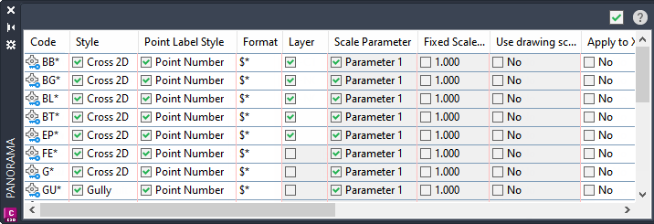

  4. Use the Description Key editor, as shown in figure 2, to create a suitable description key set to match these codes to style points, label descriptions, and levels accordingly.
    Figure 2: Create description keys editor

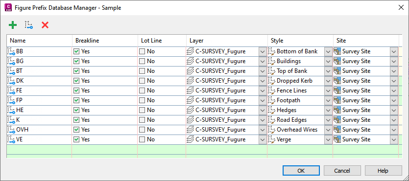

  5. Use the Figure Prefix Database Manager, as shown in figure 3, to create a figure prefix library and figure styles with which to receive the linework codes and draw the linework in a suitable style.
    Note:
    You should only specify a site if the Lot Line property is set.
    Figure 3: Specify how imported line work is drawn
    You can specify whether the linework is drawn as breaklines or plot lines, as well as the assigned layer, style, and site.

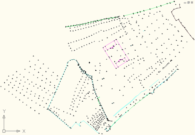

  6. Import the survey data. The results after importing the survey data into Autodesk Civil 3D are shown in figure 5.
    Figure 5: Imported survey data

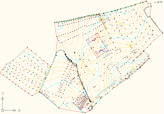

  7. Create a surface from breaklines and point groups. Then specify a contour style as shown in figure 6.
    Figure 6: Surface created from breaklines and point groups with specified contour style
