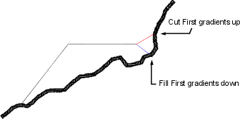

Specifies whether to search first for cut or fill slopes in cases where both would work. For example, where the target surface has a steep slope, both cut and fill slopes may intersect the surface.
  • Cut First: Creates the grading by trying to grade up from the footprint. If no solution is found, it will gradient down.
  • Fill First: Creates the grading by trying to grade down from the footprint. If no solution is found, it will gradient up.
Different results achieved based on Cut First and Fill First settings (section view)

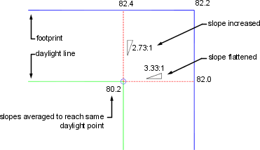

Specifies how interior corner projections are cleaned up when the footprint corner has different levels. This situation results in two possible daylight point levels. You can choose to average the slopes to reach the same point, or increase or decrease one of the slopes.
Corner level conflict (plan view)

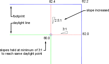

  • Use Average Slope: Averages the slopes to reach the same daylight point.

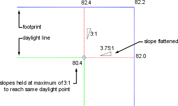

  • Hold Slope as Maximum: Holds the specified gradient or slope as the maximum and flattens out the slope projected from the footprint on one side.
  • Hold Slope as Minimum: Holds the specified gradient or slope as the minimum and increases the slope projected from the footprint on one side.
