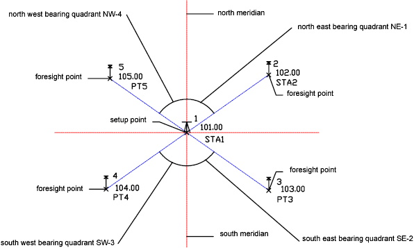

quadrant
One of the sections resulting from dividing a circle into four equal parts. Quadrant 1 is the NE corner, and quadrants 2, 3, and 4 proceed clockwise around the compass. Quadrant bearings are usually referenced by quadrant number.
quadrant bearing
An angle measured from North or South, whichever is nearest, with the added designation of East or West. The angle is always less than 90 degrees (IP/2 radians or 100 grads) and is referenced by a quadrant number.

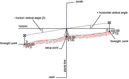

vertical angle
An angle above or below the horizontal plane. The angle is expressed in DDMMSS from this horizon. Vertical angles expressing a downhill slope from the instrument chainage are described with a negative value. Zenith angles are similar to vertical angles, except that a zenith angle has a vertical reference plane.

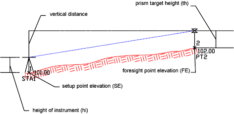

vertical distance
A distance measured along a sloped surface. For example, if you measure a distance from point A to point B that is on a 3:1 gradient, then that distance is longer than the distance measured horizontally.

vertical to horizontal
Vertical angles and distances are converted automatically to horizontal angles and distances when you adjust a traverse loop, or perform Least Squares adjustment on observed data.
