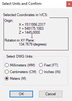

  3. In the Select Units and Confirm dialog box, select the drawing units. Click OK.
