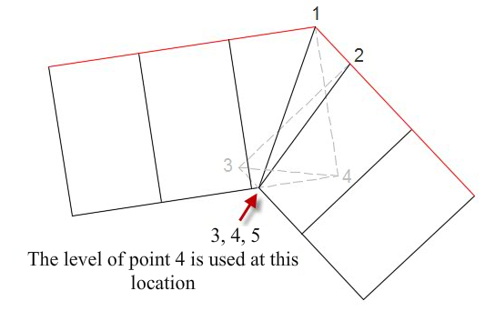

The level value that is used for the corner after bowtie resolution is obtained from one of the inner points of the bowtie as shown in the following illustrations.
The following illustration represents a corner prior to clearing the bowtie. The corridor baseline is shown in red.
The following illustration represents a corner after clearing the bowtie.
Points 3 and 4 are moved to the location of point 5 and the level of point 4 is now used in that location. The locations and levels of points 1 and 2 are unchanged.
