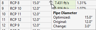

Pipe Diameter
Displays the pipe diameter.
If the Resize Pipes and Reset Inverts analysis type was selected on the General page, and a pipe diameter was resized, this column will contain either an up arrow or a down arrow. When you place your cursor over the arrow, a tooltip is displayed that explains how the pipe was resized.
