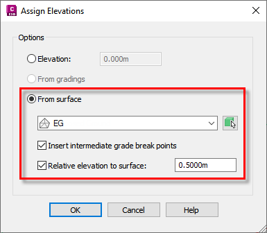

To assign feature line levels from a surface
  1. Click Home tabCreate Design panelFeature Line drop-downCreate Feature Lines From Objects Find.
  2. In the Create Feature Lines dialog box, select the Assign Levels tick box and click OK.
  3. In the Assign Levels dialog box, select the From Surface option.
    Note: If there are no surfaces in the drawing, the From Surface option is unavailable.
  4. Select a surface from the list or click the arrow icon to select it in the drawing.
  5. Select the Insert Intermediate Gradient Break Points tick box to insert intermediate gradient breaks where the entity crosses surface TIN lines. Additional level points are created at these locations.
  6. If you want the feature line to remain relative to the surface, select the Relative Level to Surface tick box and optionally enter a positive or negative offset value in the edit box. For more information, see About Relative Feature Lines.
