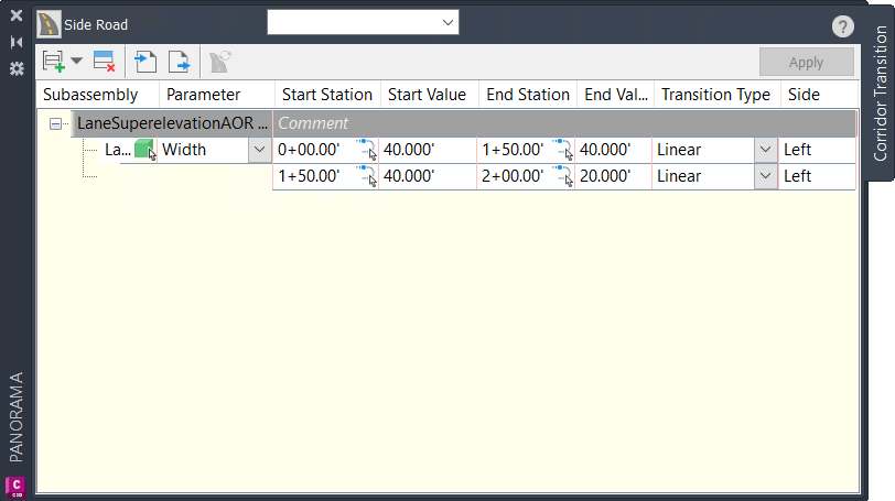

- Added a new workflow that uses a Panorama vista for creating and editing corridor transitions, which can be used when you want to transition a parameter in a subassembly from one value to another, such as when creating turning lanes or bus stops.
In the drawing, select which subassembly to transition and which parameter to transition, and then select stations, values and the transition type.
- When you select a row in the Panorama vista, the corresponding transition is highlighted with blue symbols in the drawing.
- You can export and import transitions so that you can apply them to other corridors. You can establish a transition (or series of transitions) in one corridor, and then export the transitions and import them into a new corridor or drawing.
For more information, see About Corridor Transitions and To Create Corridor Transitions.

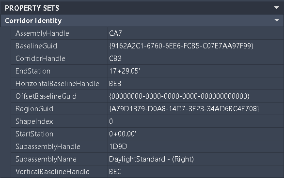

- Corridor solid property sets have been enhanced:
- Added a property set definition named Corridor Identity, which contains CorridorHandle, HorizontalBaselineHandle, RegionGuid and ShapeIndex to allow users to identify the relationship of the corridor solids and their subassemblies.
- Enhanced corridor solids so that the handle of the solid won't be changed if the number of corridor regions changes when the corridor solids are dynamically linked to the corridor.
- Fixed an issue in which property set values on existing corridor solids were not updating when changing the name of the corridor region.
- Added APIs to allow users to track back to the applied subassemblies from the corridor solid's GUID:
- OffsetBaselineCollection[System::Guid offsetGUID]: Get OffsetBaseline from OffsetBaselineCollection by its GUID
- OffsetBaseline.OffsetGUID: Get OffsetBaseline's GUID
- BaselineRegionCollection[System::Guid regionGUID]: Get BaselineRegion from BaselineRegionCollection by its GUID
- BaselineRegion.RegionGUID: Get BaselineRegion's GUID
