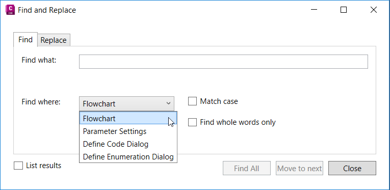

For more information, see Find and Replace.

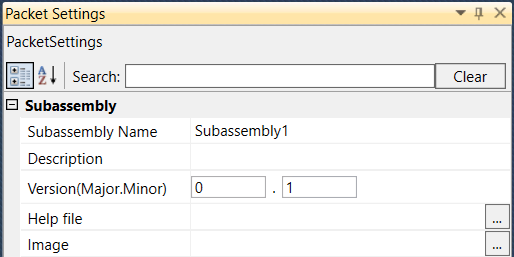

For more information, see Packet Settings Tab.
When you are using the Save As dialog box, you can also enable an option that appends the subassembly version to the PKT filename.
