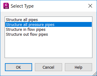

- Added the ability to label pressure pipes that are connected to gravity structures by using the Text for Each label style component and selecting the Structure All Pressure Pipes type.

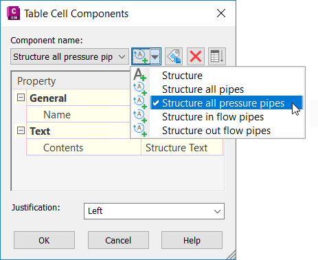

- Added the ability to add pressure pipes that are connected to gravity structures in tables.
When setting up a table column, select the Structure All Pressure Pipes option.

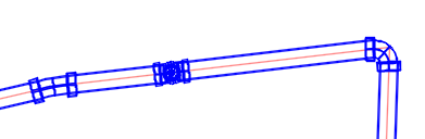

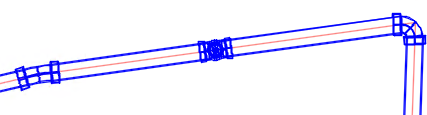

- Fittings and appurtenances are now locked to PI points when grip editing the pipe network. The fittings and appurtenances are kept in place, relative to the end of the pipe that is not moved.
| Appurtenance Location Before Moving Left Fitting
| Appurtenance Location After Moving Left Fitting

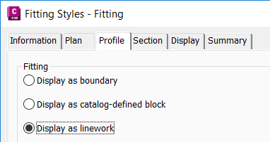

- Added Display as Linework options for displaying fittings and ancillaries in profile view. Use this option to show a simple view of the parts in the profile view.
For more information, see Profile Tab (Fitting Style Dialog Box) and Profile Tab (Appurtenance Style Dialog Box).

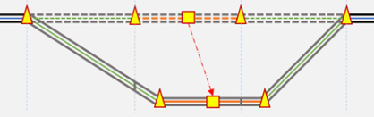

- The following enhancements have been made to the process of editing pressure networks in profile view:
- When the Offset Style for a pipe run profile is set to Cut Length, the number of PVIs on a pipe run profile is reduced so that they are placed just at cut lengths and bends.
- Added the ability to break a pressure pipe at a PVI point in profile view when editing the pipe run if the Offset Style for a pipe run profile is set to Cut Length.

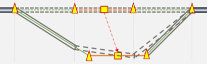

| Previous grip editing behaviour in profile view
| New grip editing behaviour in profile view
Dragging the grip would result in the pipes being drawn where the dashed lines are.
Dragging the grip results in the pipes being drawn as shown above.
