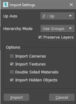

Interface - default importer
- Up Axis
- Different applications use different axes for the up-axis. Select the appropriate axis for the file you are importing. Default=Z-Up.
- Hierarchy Mode
- Groups imported objects. To preserve groupings, you can use 3ds Max groups or layers. The groups or layers are nested according to the organization of the original scene. Default=Using Grouping.
- Using Grouping: Objects are placed in 3ds Max groups according to the group they belong to in the imported file.
- Using Layer: Objects are placed in 3ds Max according to the layer in which they reside in the imported file.
- Flattened: Objects are not grouped and are imported as independent 3ds Max objects.
- Preserve Layers
- Keeps all layer information from the original SketchUp file and uses it in 3ds Max to assign objects to layers.
- Import Cameras
- Imports cameras.
- Import Textures
- Imported textures are saved in the project's textures folder.
- Double Sided Materials
- Covers faces with double-sided materials, giving the appearance of correct orientation to flipped faces. Faces will still export in their original state.
- Import Hidden Objects
- Imports all hidden elements from the SketchUp file.
