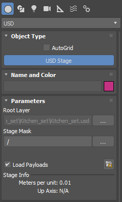

Click into the viewport to become the point where the stage loads. In the Command Panel:
Select the Geometry Icon (Circle) > and select USD from the drop-down menu.
Under Object Type, select the USD Stage button. Select the ellipses ... next to the Root Layer label to open the Select USD File dialog and locate a USD file to reference.

Use the Parameters Rollout in the Command Panel to configure or make changes to your USD stage reference at any point.
- Select the ellipses (...) next to the Root Layer label to select or change your referenced USD file.
- Select the ellipses (...) next to the Stage Mask label to choose the prim and all descendants you want to display in your scene. You can use Stage Mask to configure your display and mask prim objects you don't want to display in the viewport.
- Toggle the Load Payloads option to load/unload payloads into your scene as desired. By default, all payloads are loaded into the scene.
