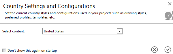

For the English and French language installations, a content selection dialog appears at the first start-up of Advance Steel. In the Country Settings and Configurations dialog you can choose the country specific settings which share the same language: English ( United States, United Kingdom, Australia and English International) and French (France and Canada).
| Don't show this again on startup check box | If checked, the Country Settings and Configurations dialog will no longer appear when starting Advance Steel. |
